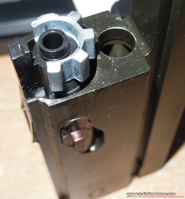

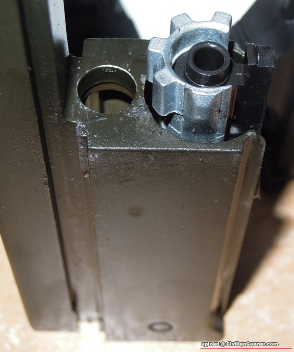

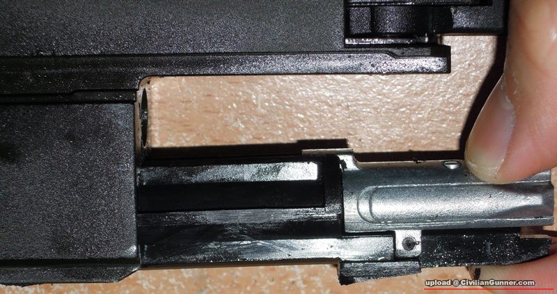

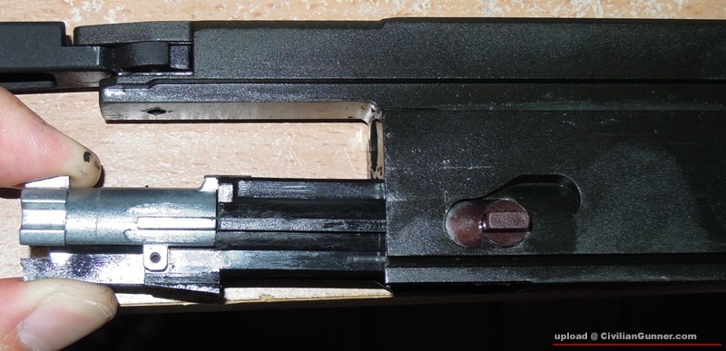

However, some potential problematic area of the internal mechanism.
1) Metal meshed with plastic, with only pins connecting. If a BB jams, the stronger metal may cause the plastic to deform or break. Perhaps VFC can later produce a plastic version of the bolt head?
2) Bolt lock only catches a small area of the bolt, which after uses the bolt itself may deform. We will see in time if this happens.

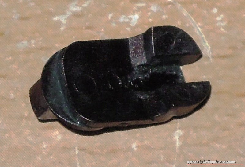

3)Finally, the end plate. This is where all the blow back takes hit, but VFC have only designed the blow back force to be taken by an insert on top, and the takedown pin below. 2 points of contact only. Also a bit worrying, but if the plastic is good enough it should be ok otherwise this is suspect able to crack.

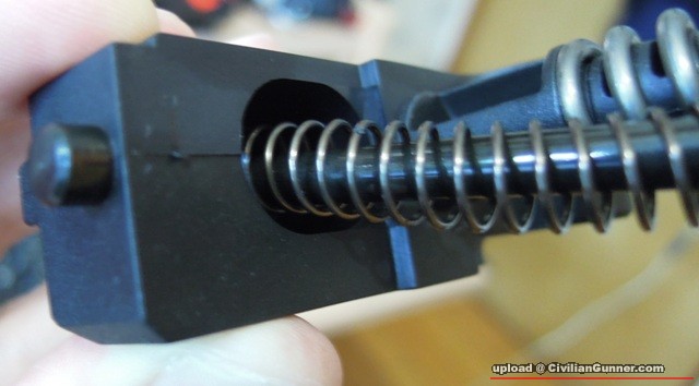

作者: dennislau1    時間: 24-7-2011 18:22
Onto parts wear. To my relieve, after 11 lock bolts or so, it still worked fine. No serious deform is noted.
No major scratches or deforms  on the bolt carrier is also seen. I think the forces are distributed out quite evenly.
And to my relieve, the rear end did not have any signs of fatigue or cracks. So i guess it can sustain some punish afterall.
[ 本帖最後由 dennislau1 於 24-7-2011 18:23 編輯 ]

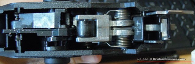

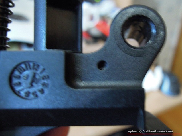

作者: dennislau1    時間: 24-7-2011 18:25
I do not have a problem with the bolt guide, now i take it apart.
Bolt and bolt carrier does not show signs of heavy wear and tear. But i still dont like the metal meshed with plastic concept, although it seems to work fine regardless.
Trigger group also didnt seem to be worn out at all. I think VFC did a great job on the trigger and lower receiver design. Unlike their M4 series.

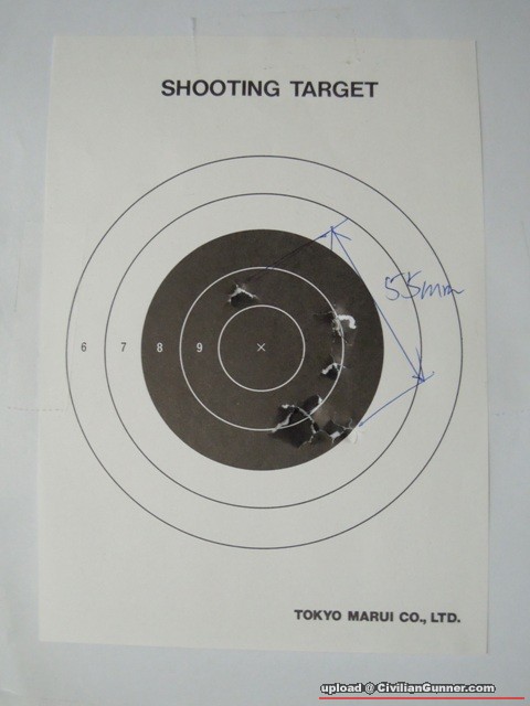

Finally on the grouping.
This is done on standing position, 9 yards = 8.23m, indoor windless. 0.25g G&G BB. Power measured at 1.4J first shot.
Grouping is 55mm. With prone or bipods this is easily be halved i think. Accurate as hell is what i think.
After getting use to the trigger, I think it wasnt all that bad at all. Just different from M4 and not unacceptable.

作者: kei_2000s    時間: 22-9-2011 15:36     標題: 回覆 33# 的帖子
拉後個bolt, 慢慢用一字批”叫”出黎啦,記住hop up制推到最前,呢個野好易“叫”爛。
尼個係我其中唔鐘意既地方。

作者: kei_2000s    時間: 5-10-2011 10:08     標題: 回覆 39# 的帖子
需然36C個原裝bolt 算係硬淨, 但如果之後有人出 upgrade part, 咁呢件野打左螺絲膠, 粒機米咁細一擰就滑, 根本拆唔到出黎. 咁係唔係一個問題呢?? 咁當然你可以比人整啦... 但好多師兄都鐘意自己動手, 包括我在內.
我自問甚小打 game, 一年先一次果隻, 你都可以話我無打 game 既經驗而唔G 道相關既要求. 不過我鐘意裝裝拆拆. 我之前響呢個 post 寫既都係個人見解, 當然唔同人有唔同睇法啦, 師兄你要完全否定我都無法子既.
作者: kei_2000s    時間: 5-10-2011 10:21     標題: 回覆 38# 的帖子
有, 不過之後搵人幫手CNC做過隻.....

作者: dennislau1    時間: 5-10-2011 11:12     標題: 回覆 41# 的帖子
Wawawa do you mind make one for me too?
作者: kei_2000s    時間: 5-10-2011 13:27     標題: 回覆 42# 的帖子
P.M me if u really need, I still have 1 spare.
