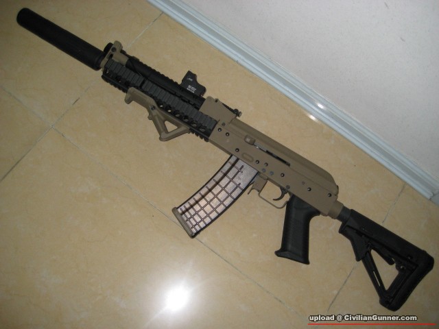

小弟的 Magpul AK (MAG-K).  Spent a lot of time on this project.  Now complete
Chris Costa/Travis Haley's MAG-K:
Dynamics V2:

作者: noveske    時間: 14-9-2011 23:51     標題: 回覆 6# 的帖子
I thought about GBB,  but no Belgian Polymer style mag available for GBB.
Parts list for my MAG-K:
Base/Receiver: Supposed to be Saiga, but for airsoft, I used a VFC AK104PMC and removed scope mount, filled holes, painted Magpul FDE.  Top cover is smooth style AK47 cover cut on left side for custom charging handles.
Bolt: LCT Steel bolt with ambidextrous ACR charging handles
Mag Catch: KA Extended Style Magcatch
Grip: Supposed to be MIAD w/ grip adaptor, but I tried and couldn't fit the MIAD, so I used the Mag K V2 style: SAW style grip
RIS:  Ultimak Scout & lower rail
Stock: Magpul CTR w/ enhanced buttpad
Flashider: AAC556BK style, but I use Dytac Tri-lug (18T) style.
Magazine: Beta Project AK Polymer Waffle Mag with Magpul Ranger plate for PMAG

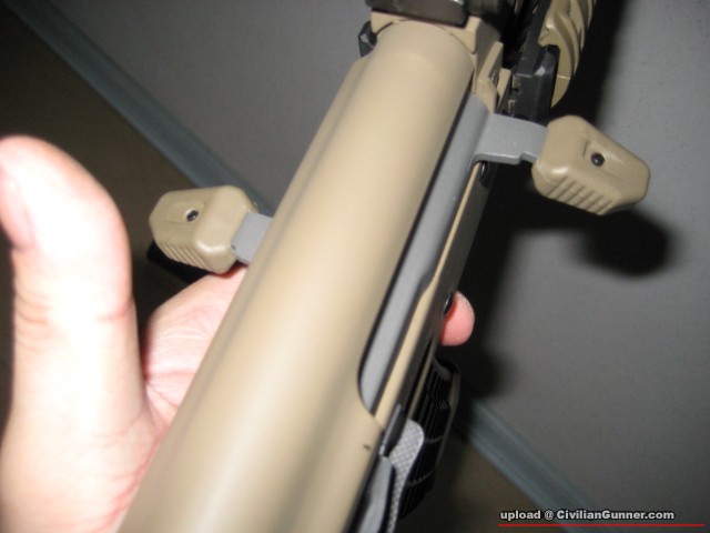

原帖由 noveske 於 14-9-2011 23:02 發表 AEG.
請問份bolt 係點整? 定係買現成玩具/改件?
作者: noveske    時間: 15-9-2011 08:06     標題: 回覆 11# 的帖子
I used ACR charging handles and welded on to an LCT Bolt.  I wanted to use a full VFC bolt, but repositioning the battery to the stock would weaken the stock joint.  Because it is an AEG, he bolt/charging handles is only for looks (and to adjust hop-up)

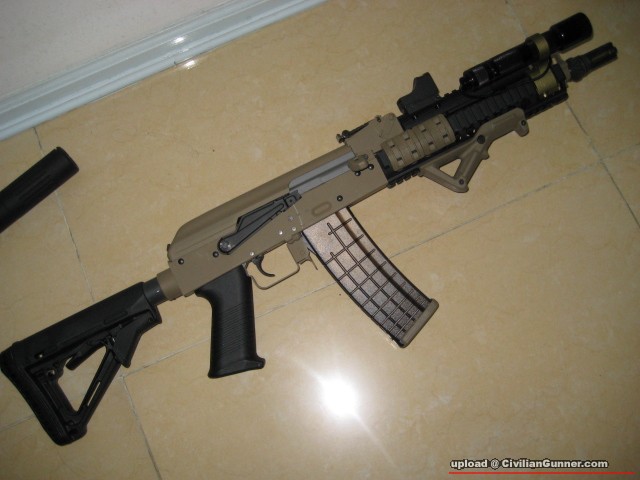

作者: noveske    時間: 15-9-2011 12:22     標題: 回覆 13# 的帖子
Here's the parts list:
Base Gun: VFC AK104PMC
Receiver Modifications:  Removed rear optics mount & filled holes.  Also filled receiver indent above magwell:
Paint: Brownell's Alumahyde II Coyote
Upper RIS: VFC  (Ultimake Scout Style)
Lower RIS: Ultimak
Bolt: LCT Steel Bolt w/ custom welded ACR Charging Handles
Grip: KA SAW style
Mag-catch: KA Extended type
Stock: Magpul CTR w/ Enhanced Buttpad
Flashider: Dytac Trilug (AAC18T style)
Magazine: Beta Project AK Polymer Mag w/ Magpul Ranger plate for PMAG
Others: Surefire M300A w/GS Mount & Rail Switch, Magpul AFG, XTMs, Cheap-cheap Docter Replica Optic

作者: noveske    時間: 18-9-2011 21:26
Before/After:

作者: VEC    時間: 24-9-2011 16:23
請問真鐵開火時, 左邊個cocking handle會否同個bolt一齊跳呢?
作者: noveske    時間: 24-9-2011 17:47
原帖由 VEC 於 24-9-2011 16:23 發表
會!
