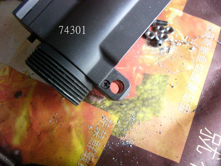

°¨¦Ñ¤GM¨t±`¦³·nÀY¨Æ¥ó¡A·íµM´«ª÷Äݨ¤@ÅéºÞ³Ì¦n¦ý¹ï¤@¨Ç³ßÅwDIYªB¤Í¡A¦b³o¥i´£¨Ñ¤@¨Ç¤ß±o

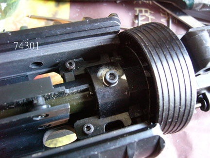

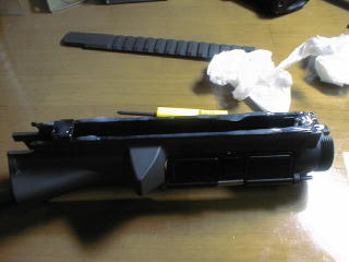

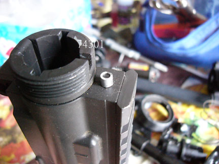

¶}©l·íµM§âM4©î¶}
![](/repair/images/1.jpg)

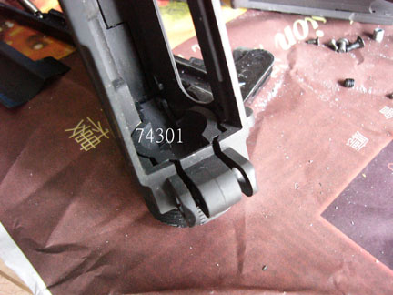

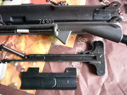

¤W¨«e¬q¦³¤@ª÷ÄÝ°é°O±o©î¤U

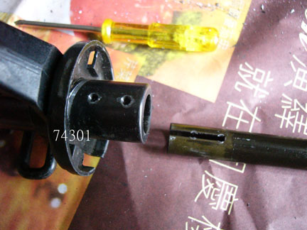

±µµÛ©î¤U¤W½£´w

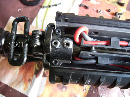

![](/repair/images/4.jpg)

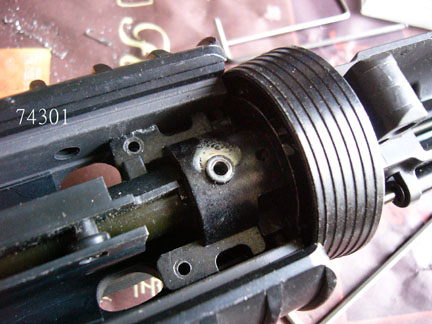

³»ÀYªºÁ³µ·³£n©î¤U
§â³»³¡RIS¾ô¦V«á±À«K¥i©î¤U
§â«e¨âÃä¤pÁ³µ·©î¤U

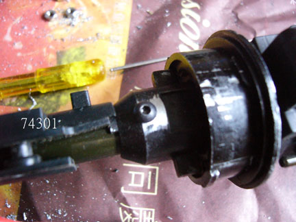

![](/repair/images/8.jpg)

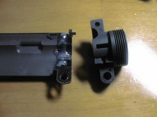

«K¥i§â¤W¨¤@¶}¤T¡A§â¥¦¥Î½¦¤ô±q·s±µ¦X«K¥i
¥i¥Îcutterªu±µ¦X¤fºCºC¤Á¶}
³»¾ôRIS±q·s¥Î½¦¤ô±µ¦X«K¥i

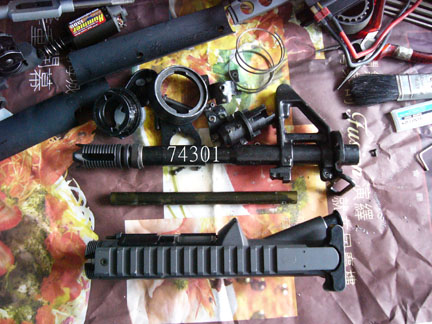

¸òµÛ«K¥i¦w¸Ë¦^¦U³¡¥ó
¸¨½¦¦a¤è¥i‰ë¦Ò

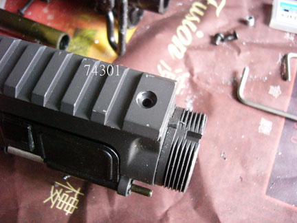

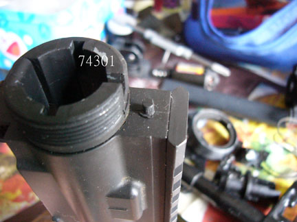

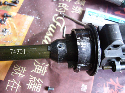

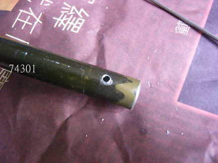

ºjºÞ«e¬q¦w¸Ë¤èªk(¦p¹Ï)
ºjºÞ«á¬q¦p¹Ï¥Üªº¡A¥~ºÞÆp¤ÕÅͤú3mm
°OºòÆp¤Õ«en¹ï¦n«e«á·Óªù¦¨¤@ª½½u

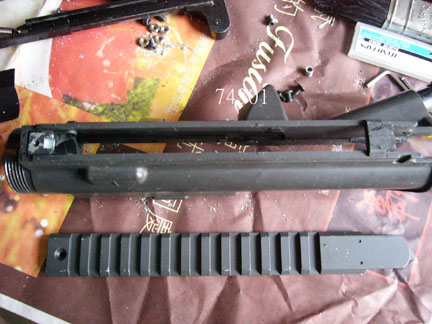

![](/repair/images/12.jpg)
³o¼Ë«K¥i¦¬¹ê¥~ºjºÞ¦b±µ»é¾¹¤¤

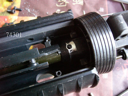

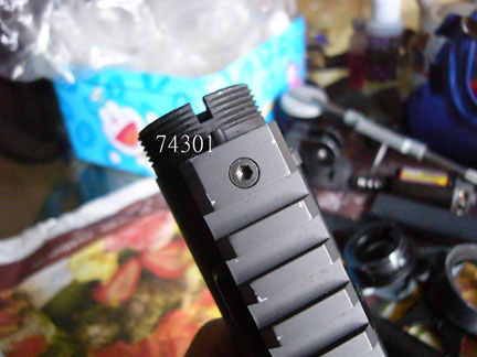

RIS«eºÝ¦p¹Ï¦w¸Ë
RIS«áºÝº¥ý§âè¤~¤W¦nªºÁ³µ·©î¤U
¦b¸Ë¤W¦¹³¡¥÷¹s¥ó
![](/repair/images/17.jpg)
©T©w¤èªk¦p¤W¡A¨ä¹ê³Ì¥Dn¬O½¦¨±q·s¶î½¦¤ô©M¥~ºjºÞÆp¤Õ¦¬Á³µ·¡A³o³¡¥÷¥i¦h°µ¦h¤@ÁûÁ³µ·¦bªð¤è¦V¥O¥¦ºò¥[©T©w¡AÁÙ¦³©Ò¦³Á³µ·ªøµun«ê·í¡C
screws¥i¥Îm3¡Am3.5 ©Î m4 ¦ý m3¹ï die casting ²Õ¥ó¤ñ¸û©ö"¹F¤ú"~~~
½¦¤ô¥i¥H¥Î Loctite 495
