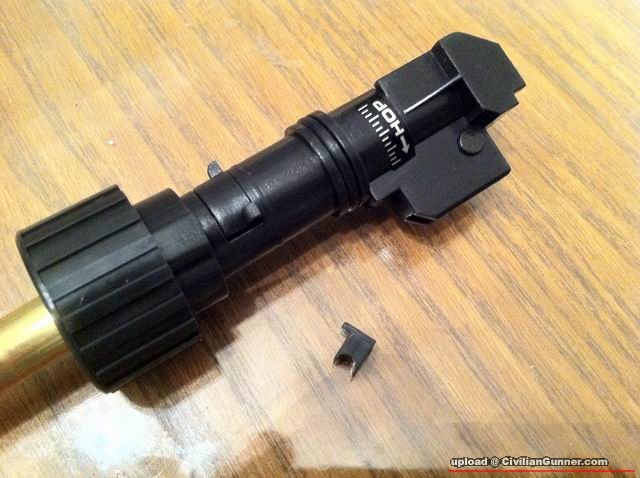

G36 換內管 手術突發(射)事件問題...
入左支馬記G36c後... 第一次幫佢做整容(?) 手術..
就係幫佢由G36c 變左 G36..
換內管當然就小不免 la~
但係換換下突然有舊野 突然發射左出黎..
管就換好左喇 (貌似)
但係飛左出黎果粒野 到抵應該放係邊丫...?
謝謝各位師兄既解答...

This is the part which presses the tiny rubber against the hopup bucking. It should be placed underneath the hopup lever.

呢粒野係食住粒老鼠屎用
應該放係HOP果張貼紙箭咀指住果面果個坑道
詳細可上網搵MARUI G36說明書

唔該曬兩位師兄!
頭先繼續爬文 最後終於都搵到:
http://www.wargameyau.net/viewth ... &extra=page%3D1
我估而家知果粒野應該放係邊喇
陣間食埋飯再放番入去先!! Thanks!
