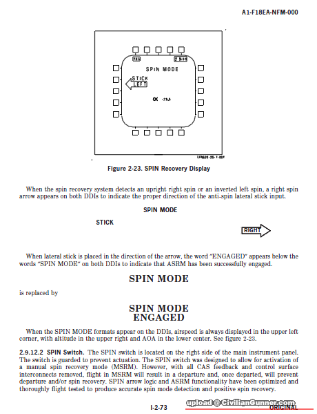

事發中CF-18又無事->Tailspin目視估計只係drop左no more than 100ft.

btw師兄有無學過stall/tailspin recovery呢...
