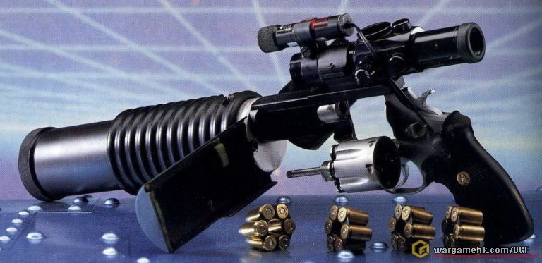

Nagant m1895«Y¦³·ÀÁnªº,¼uÀY±J¤J¼u´ßùØ¡A·í©Ô¤Uhammer·|±À«e¤l¼u¡A¥O¤l¼u«e½t¤p¤p¶i¤JºjºÞùØ¡A·íµo®g®É¼uÀY­¢¶}¼u殻¤WÃä½t¦ì­¢¹êºjºÞ°µ±K®ð¡A¤§³o´N­ø·|¬ªº|®ðÅé
¸g¨å¥ýÅX
説¨ìÀR­µ½ü, ¤£¯à¤£´£³o¤ä¼w»sºë«~:
Peters PSDR III suppressed / silenced revolver
¦@ 1 ­ÓÆg¦n! TOP

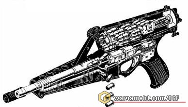

It would be rather heavy when fully loaded, but it may be too light when empty.  Seems difficult to balance......? ~?
·í¦~ Thompson 100­¸ drum ¥ò¥X¨Æ
