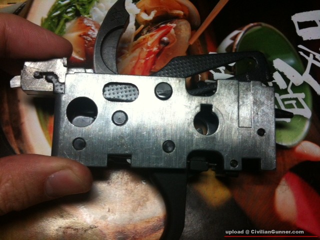

I just installed the steel hammer from Blacktalon but afterwards it can only shoot semi
any ching got this problem as well??

I changed the bolthead with valve, extractor, extractor spring and the hammer set....
but i did not get the steel sear from them. Maybe that's the problem?

let me try to take some pic tonight.
thanks ching for your video

I only installed the BT hammer set and everything else is original VFC

This is how it stopped the cycle in full auto when the trigger is pressed
