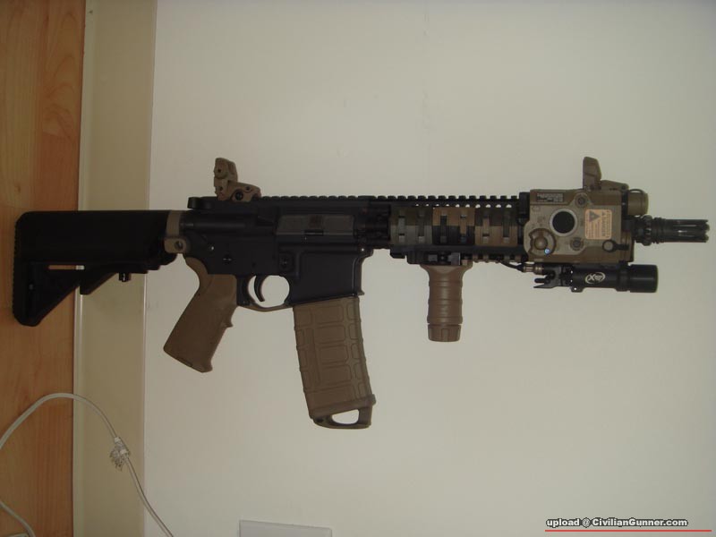

我仲未入到gbb住, 要今個summer 返hk 先入 不過呢個係我ptw 既setting. 骨係dd 10" ar15 lite.
(39.03 KB)
5-5-2009 21:07
等緊magpul 個acs stock 就大功告成.
