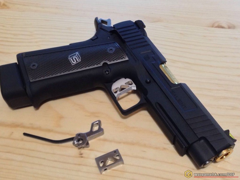

呢幅圖見到佢Grip Safety及Safety Lever都係特規, 彷間的鋼四寶應該不合用了
其餘Hammer及trigger等等未有時間打散佢黎睇...>>> 已經試換了, 與馬記兼容 http://www.wargamehk.com/cgf/viewthread.php?tid=166698&page=3#pid1266249
諗住就咁用小弟本身支Nova SAI上身插入佢caspian下身又唔fit位, 要執執先得
上下槍身色水不一致, 唔知係咪支支都係咁
同小弟本身支Nova SAI合照, 呢度見到外管比較短.

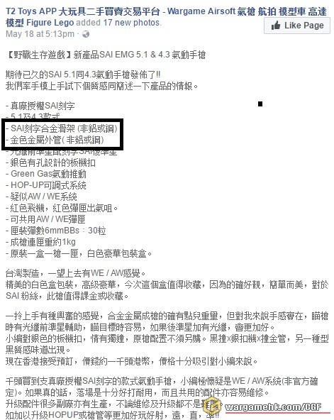

原帖由 kai_matt 於 29-5-2017 18:16 發表
唔記得睇度fb講名係合金,唔係鋁
i guess it's this one..
and it's different from what they posted here...
"Features
Machined aluminum alloy frame and slide provides rugged reliability without sacrificing weight...."
http://www.evike.com/products/66355/

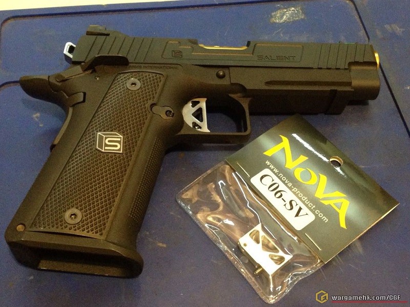

原帖由 horenhim 於 1-6-2017 01:45 發表
頂唔順個trigger改下佢, 懶人做法.
http://i141.photobucket.com/albu ... 7-95DE-4DBC-801B-43 ...
勁! 請問trigger ring改了什麼?
三叉片有無做手腳??

厚裝隻trigger真係好唔掂, 唯有換左佢
順便換埋hammer試試兼容性
可惜sear 係特規, 未必夾到其它hammer, 如某些Nova或CP(通常有跟自已sear那些)
Nova, 吉打等等的hammer洞比較fit, 應該要執少許就入到, 但sear方面未必夾所以得閒再搞...
換完trigger及hammer靚仔返小小
