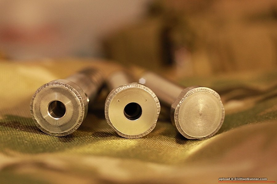

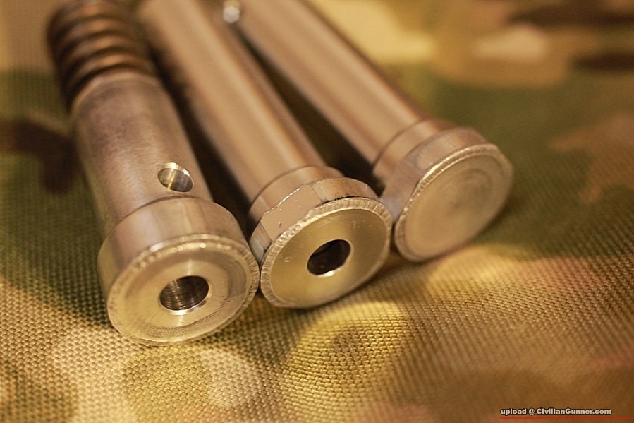

Ching 們你地隻Buffer打左幾多飛??
損傷程度去到邊呢??
26-3-2010 19:33
左:約1000, 中:過萬, 右 :約4-5千
26-3-2010 19:33

左邊o個個係唔係好勁blowback 呀?????我都想買個玩下......
我果D都好傷了,其實有咩方法可以減低損傷呢?,

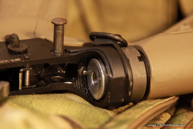

lo兄可否影你個裝完Buffer既尾通比小弟睇小
小野thc
Ken's Custom Magpul M4
Similar wear and tear. I don't think that there is a good way to dampen the wear down process. What I did was to lengthen its lifetime by sanding off the edges and smoothen it again.
回覆 3# 的帖子
Here you go~~

估計支鎗個bolt做細左少少,
個stopping point前左,所以個buffer每次回前都碰到個pin,
所以做成這樣子傷痕,
建議你有在個bolt個尾加長少少,
我估計有改善,加個膠底,
好似prime,有跟個bolt送。
原帖由 SSD 於 12-4-2010 23:35 發表
估計支鎗個bolt做細左少少,
所以做成這樣子傷痕,
建議你有在個bolt個尾加長少少,
我估計有改善,加個膠底,
好似prime,有跟個bolt送。
是真的
正常係條bolt尾頂住Buffer 變成主要受力位不是粒的,而是飛機
以上程況是bolt 唔夠長/粒的頂部過粗令到Buffer 硬撞粒的所至
