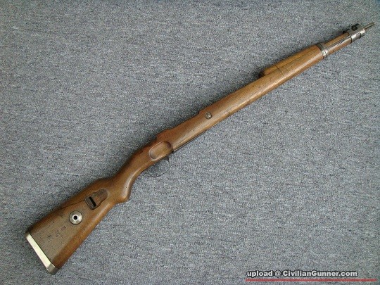

兒時睇槍,覺得槍祗有兩種〝長槍〞同〝短槍〞。而〝長槍〞又以有木托為標記,愈長愈好。久而久之,搞到依家愈來愈多木托。
但啲舊木托上啲塵年老積,金屬�袗n,再加埋啲〝歲月〞舊化,同槍油嘅味道,簡直係....

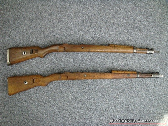

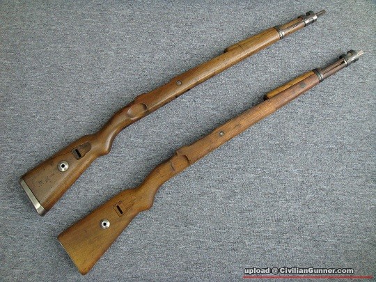

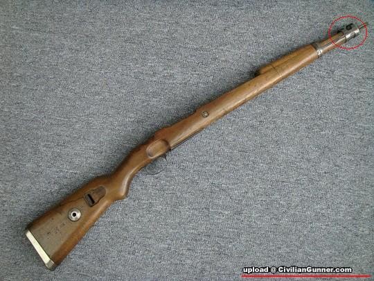

先前以有一個 Mauser 98K 木托,但在網上見到一個重靚啲嘅 K98K 木托,二話不說,馬上PAY NOW,估唔到個英國佬咁老實,報 OLD WOOD STOCK 咪好囉,偏偏下面加埋句〝RIFLE STOCK〞搞到Fedex叫我寫個證明比香港海關,作咩用途。噚日下午終於安全送件。 真係好靚!好多鷹應同marking,仲要對晒nos.果隻  馬上比較先前嗰個木托,發覺短咗DD  小弟知道 Mauser 木托有好多款同好多不同廠家制造,mountain troop 用嗰支又會短啲! 但請各高人C-Hing指教 1943 嘅K98K係唔係短啲呢? 感謝!感謝!

我唔敢好肯定咁講
唔知係唔係可以換定點
不過就我所知1942-1944果期既98k個前節應該唔係咁樣
(我識好少野!有擔心請求教專家,唔好信我呢個黃陸!)
[ 本帖最後由 sunny2014 於 25-6-2011 12:35 編輯 ]
原帖由 sunny2014 於 25-6-2011 12:32 發表
我唔敢好肯定咁講
唔知係唔係可以換定點
What kind of 前節 are you talking about, if the stock is ONE piece of wood?
do you mean handguard?
To me the darker stock looks excellent.
The light one seems to be a early war stock, but maybe heavily sanded

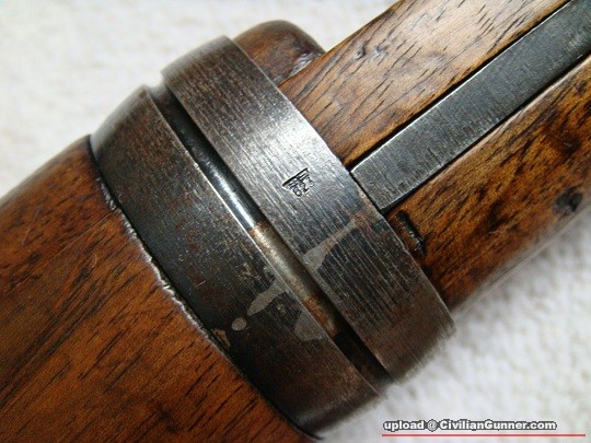

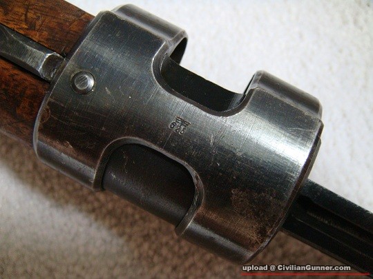

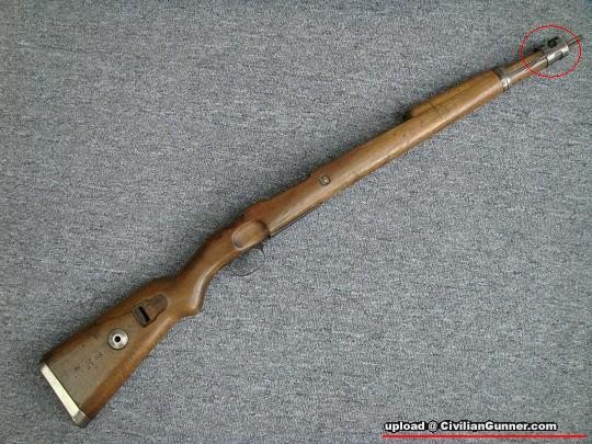

我指呢個位
26-6-2011 00:03
repeated please delete
原帖由 sunny2014 於 26-6-2011 00:03 發表
我指呢個位
we call this part upper band.
It looks very similar, if not the same to my tanaka 98k, or some other Internet photos of 98k on web.
There exist variations of upper band (probably most of the parts) during production of Kar98k during WWII, this one is called "H style".
Which model did you compared to?
[ 本帖最後由 Natrium 於 26-6-2011 01:45 編輯 ]

There also exist "soild style" and welded front band,
welded front band are frequently used in Kriegsmodell.
[ 本帖最後由 Natrium 於 26-6-2011 01:27 編輯 ]

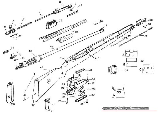

多謝Sunny C-Hing指教,你嘅見解完全正確.  正確嘅K98K 1943 個upper front band 巳改為solid band ,因二戰後期,資源缺乏,要易於生產.  亦正是Natrium C-Hing 指出嘅solid band ,而到1944 年底至1945年初,更改為welded front band 〈見圖〉.
但我個woodstock啲metal parts,全部跟晒production no. 連個Band Spring都係同no.  真係唔捨得換  而個H band始終係 Mauser 98K嘅一大特徵. 所以一般玩具生產商都用H band

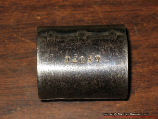

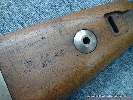

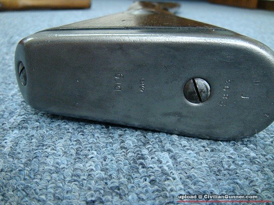

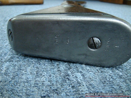

just a short note that ... the number under the Weimar Eagle is not a production code ... it 's a Inspection Team number ... some sort of nowadays' QC stamp ...

MKF Ching
my opinion is even if the transition from H to solid was made on 1943
would mean that some are H and some are solid.
some deeper discussions on k98kforum:
http://www.k98kforum.com/showthr ... -Front-Barrel-Band!
if your stock is all matching,(and the seller is reliable) keep the parts together...

Thank you C-Hing.  Yes!  These are approval codes or nowadays what we mean Q.C. codes.  Please find photo showing some example on the positon of these stamps and codes.
