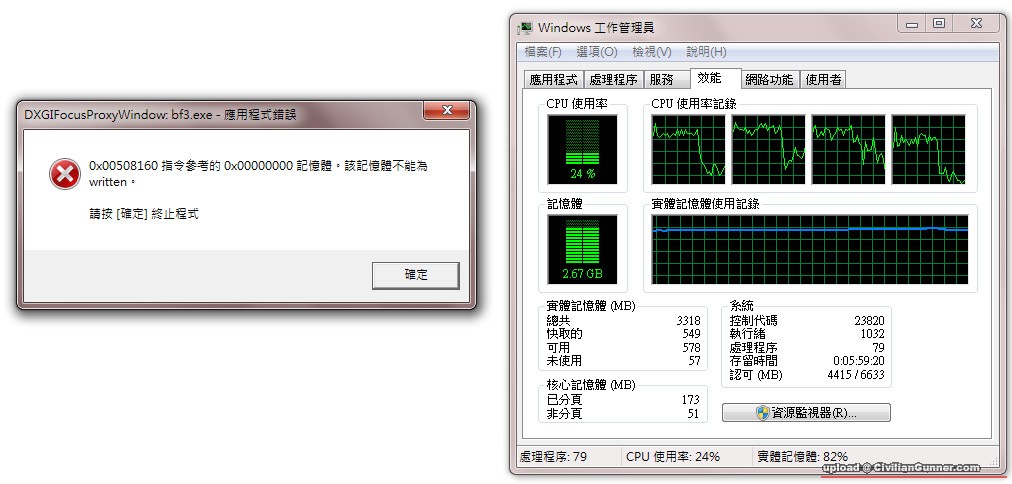

For 終於入到game and then  畫面突然hold 住 followed by BF3.exe 發生錯誤
solution :
如GPU Core個Clock如果係OC左或者出廠就預超左
請降番為正常既速度
可以係你Display Card官網download software降頻
呢個方法 another forum 有人講過
呢個係DX11 Card玩DX 11 Game先有既問題(所以點解好多玩家用舊卡玩反而無事)

有時入GAME/轉場一開始就黑畫面無哂反應.....
彈game果陣,ram用量並無特別增多,係咪即係話應該唔關ram事?
9-11-2011 16:28
原帖由 亞爾多 於 9-11-2011 16:28 發表
how many ram u got ching?

4GB
32bit win7(即係得3.幾)

then, seems to be not enough ram, can CHing buy one more ram? since 4 GB in Win7(32) seems is "just" enough to run
原帖由 p7009212 於 12-11-2011 12:06 發表
Win7(32)都唔支援更多ram啦...
