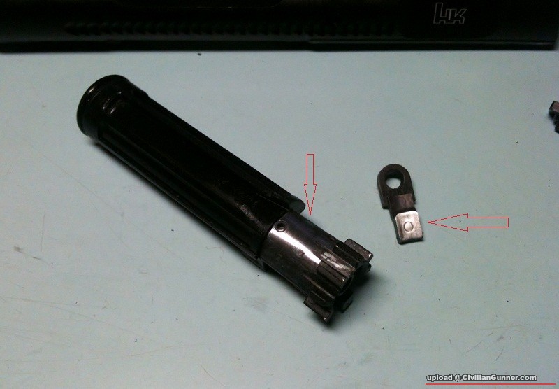

«Y, §Ú¨£¤ä­ì¸ËKA BOLT ³£¨£¥»¨­¦³ºØ¥ª¤ä¿û¤ä (§Ú¦ôÀ³¸ÓÉNÚ»¿ù)...¥t¥~§Ú¤äKA ³£¦³¥[°ªBOLT STOP, ©Ò¥H LOCK BOLT ¶ôºô²y©ç·|¦n±× ...  ¦ý, ¦pªG¥´¥´¤U­Ó­Ó©·¦ì¤S¥X²{¤Ï ·|­ø·|LOCK ±o­ø°÷©w, ¦³®ÉCHOK ¤U´N©ñ B ...
§Ú¤S¦P§A§j吓KA¸g.........
¿û¤ä¤U­±·|¶ê¨¤«Y«öbolt stop©ñbolt¿i¥X嚟,¥u­nlock bolt®Ébolt stop¼u±o°÷°ª­¹¨ì¿û¤ä´N¦ní°}......
ÁöµMbolt stop¦ì¥ò¦n§¹¾ã,¦ý°×¹]boltµL¥iÁ×§K«Ybolt©³¯P,©Ò¥H¿ûbolt«Y¥²¶·.........
´Nºâ¦³¥[°ªBOLT STOP,¦ý°¦§X«Y«}¥i¥H±Nbolt stop³»¨ì³Ì°ª¥ý«Y­«ÂI........
°ò¥»¤W§Ú©O¤äKA¥u­n°÷®ð´N¤@©wlock¨ìbolt..........

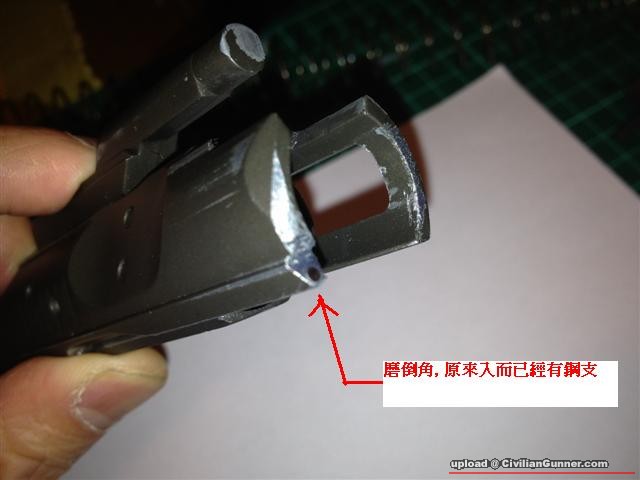

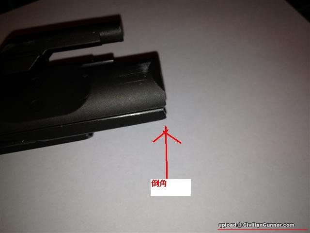

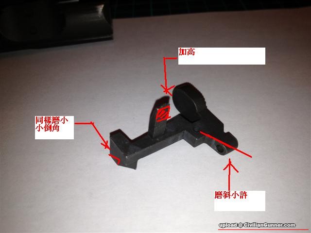

ÀY¥ý·ÓF22¥S¬J¤èªk«Y°¦­¸¾÷ùØ­±¥[¥ªÃ­À£¥ó³¥,¤äºj­Óauto§Y¨è­ø¦Pfeel
¤U¤U³£¥X¨ì
¤£¹L§Ú¦w§¹Ä±±o°¦­¸¾÷­ø°÷¶¶,¥ò«Y¦³D¥d,¹L¨â¤é¦A¸Õ¤U¦³ÉN±o¶¶D
¥t¥~³»boltÀY­Ó¨ì,§Ú«ØÄ³¿i·Æe¨â­Ó¦ì,°¦­¸¾÷·|¦A¶¶D

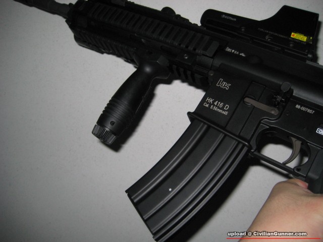

¥t¥~¥ò·Q°Ý°Ý¦U¦ì®v¥S,¤äHK German Vertical Grip (¨£¤U¹Ï)«YÃä«×¥i¥Hݯ¨ì? (¯u«~ª±¨ã³£±o~)
http://www.hkparts.net/shop/pc/catalog/hkverticalgr ...
«YaegºÞ,¥u«Y²Ébarrel nut«D±`~~~~«D±`~~~~~~~~~~~«D±`ªººò............
¥t¥~¤äHK German Vertical Grip§Ú³£¦³¤äVFC°µ,响¤Q¥|¼Ó¶R........
