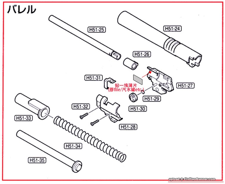

Try this

多謝CHING解答 真係好似改善左
