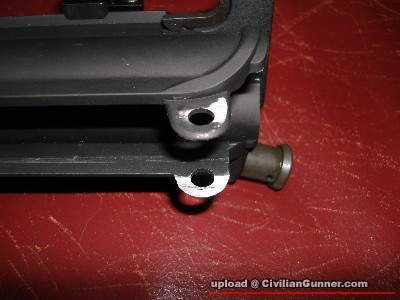

I just finished put together those stuffs... but the only problem I do have now is the Gearbox can't put inside the Guarder Meter Reciever...
Guns... lots of Guns...
first the details close up picture of the Guarder Meter Reciever... (they are same idea as the TM one... so if you can get the break up manual then you can easy to put it together)
and for the GnP RAS... is it this one?
and here is my WIP picture... I can't put back the gearbox back into the Metal Reciever...
hope this can really help you out a bit...

B20兄, 俾多張圖你look look, 我要執執'耳仔'位嚟就番波箱既杯士位

回覆 #3 LifeAfterDeath 的帖子
LifeAfterDeath兄:
絕對唔可以用馬記裝M4那一套來裝吉打呢一套!!!
吉打要波箱入上半身 先(Step 15 &16)
我裝時弄傷了手指...
才可以套下身,Zero Tolerance !!!
一定要磨耳仔...
