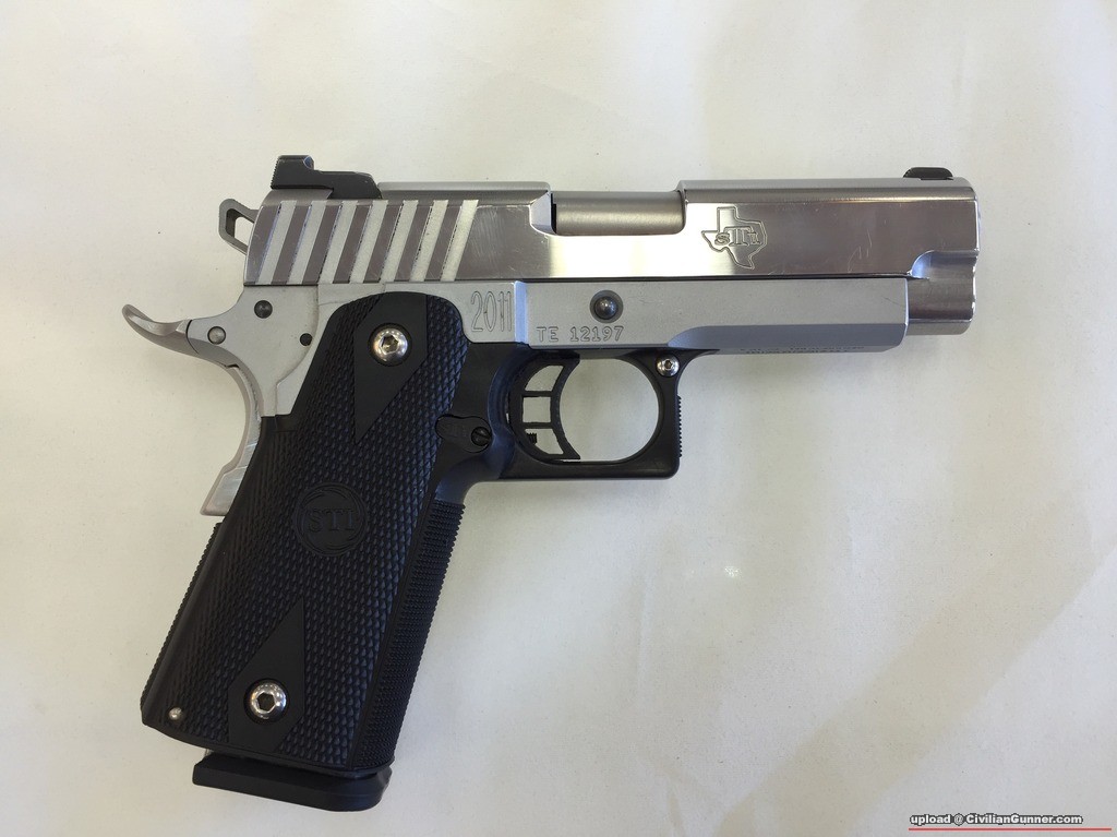

Lazer Lee個STI圖案.去過好景27/F問,店員話要劃圖? 而老闆不在,要E-mail再問..未覆!!

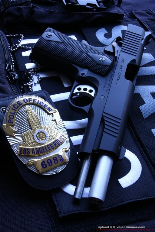

You mean this badge?
IMG_9828 (Medium).JPG (99.42 KB)
22-3-2015 02:58
LAPD
229595
呢D大路MarK,好多時佢地都有係度,打電話去問啦,搞掂寫包膠。
