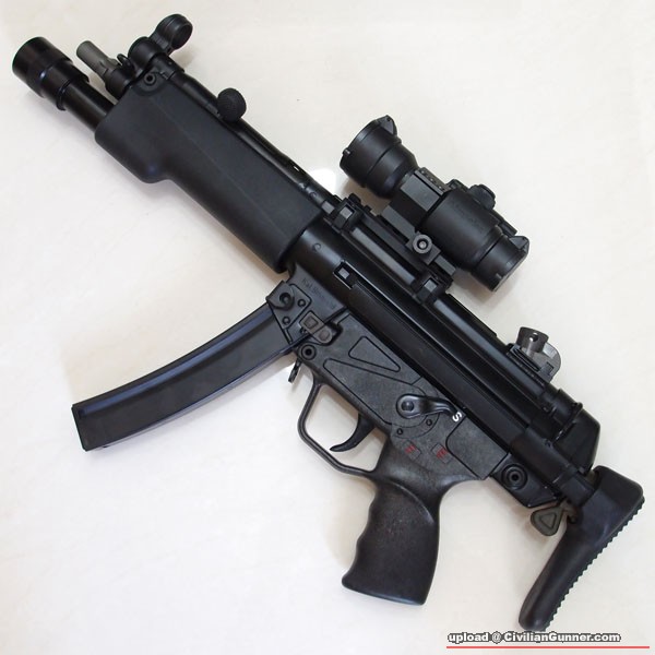

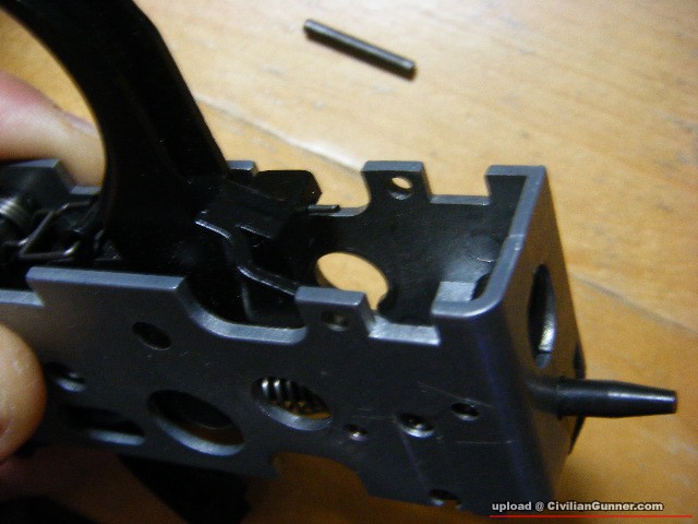

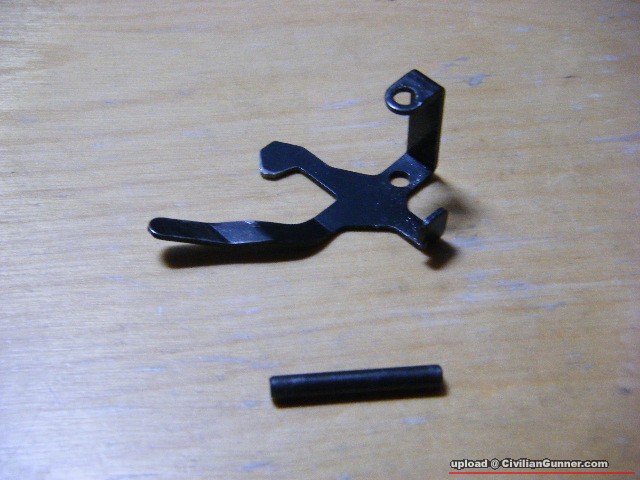

if Ching Use A3 Grip for VFC , U need to remove this parts, coz this is for A5, and cut th little pin that stop this parts, and the A3 seletor can be normal move to the 'F' position !

整返上去咪可以玩返A5囉
can be become A5 that install with that parts
I Love my Yuki Meow
無痛直上

原帖由 RCman 於 10-9-2011 11:26 發表
師兄,請問邊條pin?可以圈出來呢?我唔係好知邊個位. thx

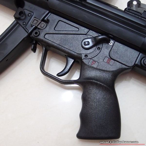

That's why we decided to buy the W~C grip set, W~C selector is tailor made for it's MP5A3 grip, NO NEED to do any modification.
NOT every owner likes to damage his own GBB to fit the new stronger parts, otherwise we can't have the original GBB after installed all stronger parts later.
We bought W~C grip set because it just need to install the whole set on the original VFC and you may reverse the installation at anytime in your own will without any damage.

Hello, the grip in your attached photos seems to be the W~C grip set that I got from 14 F yesterday.
Right ?
原帖由 Armourer 於 10-9-2011 15:05 發表
Right ?
yes,
